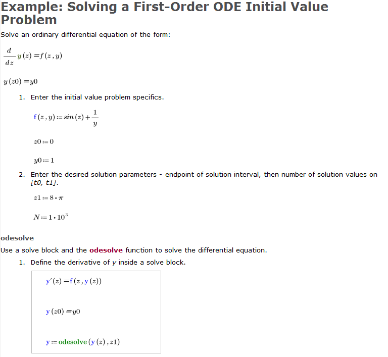

Look it up in help, where you might find:

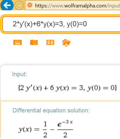

23-Emerald V
March 8, 2016
Yes Valery,
Here is the Mathcad (11) solution for the general problem:

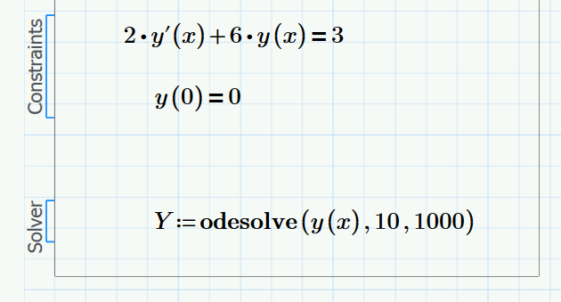

But  I think the OP needs to learn how it's done numerically, with a solve block.
