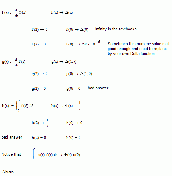

Hi.
The only one piecewise continuous functions that you can use for symbolic calculus is the heaviside step (F + Ctrl G).
The problem is that it's derivative isn't a function, it is a 'distribution'. The symbolic representation for it is Δ(x), but you must to provide your own numeric representation, because there are not only one, actually it is the limit for some succession of functions.
The second derivative of Heaviside step involves Δ(n,x), where n is the derivative degree of Δ, another distribution without an unique numeric funcional representation.
Those both function can be found in the help under "Symbolics and keywords/Symbolic functions".
Best regards.
Alvaro.

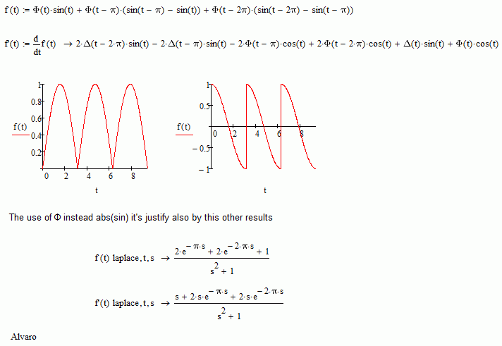

October 12, 2016
Hi.
This kind of a sine-like function?
Best regards.
Alvaro.

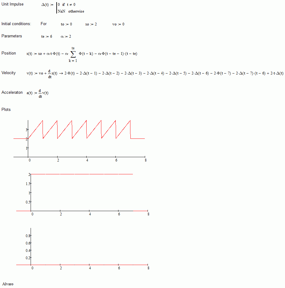

October 12, 2016
Hi Jan
Attached shows how to use Heaviside step to implement a sawtooth displacement, and get the velocity and acceleration, which actually it's zero.
Best regards.
Alvaro.

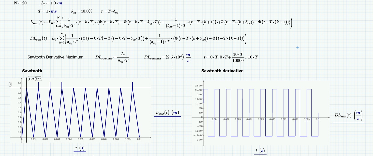

October 13, 2016
Hi Jan,
What follows is my attempt to solve your problem, but deepening were born other.

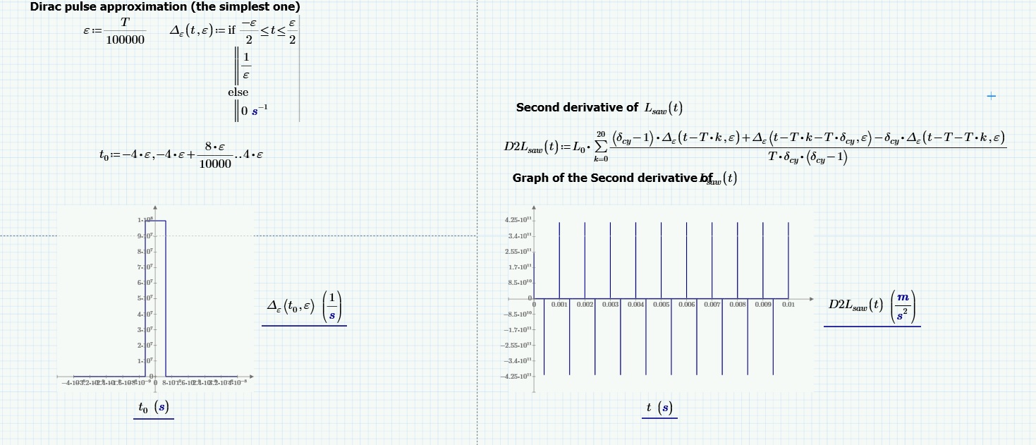

As regards the second derivative, it will be formed by positive Dirac pulses (of unit area, and infinite amplitude) on the rising edges  and by negative pulses on the falling edges of the first derivative.
What to do to avoid the spikes?
destructive impulses:
