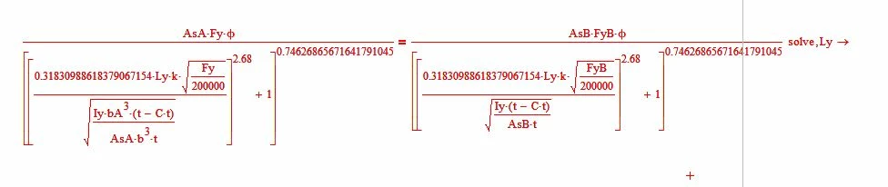

Hello there,
I'm an engineer by trade and am doing a bit of light theoretical work. I have limited experience using MathCAD for anything other than basic calculation sheets.
I have two equations that I've defined symbolically, and I have defined all variables and Boolean relationship. I'm attempting to use the "given": ___ "find":____ functions but am not having much success.
Attached is the sheet I'm using. Essentially I've defined CrA and CrB algebraically. I would like to solve for "L" symbolically such that CrA=CrB.
Intuitively I feel that mathcad should be able to crunch out some sort of relationship that I can later simplify.
Any suggestions from the more experienced users would be greatly appreciated!
Andrew

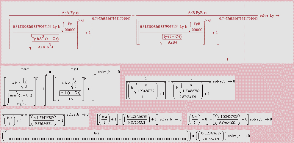

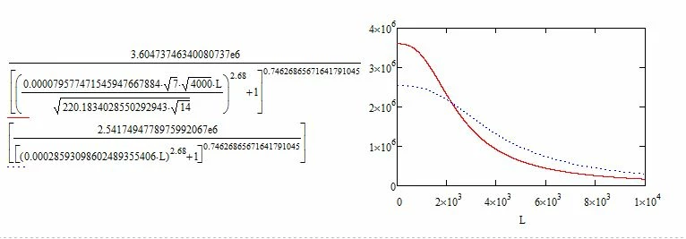

Apr 12, 2010 7:00 AM UTC
Thanks for the replies guys. Still having difficulty. I managed to simplify the equation I want to rearrange - see jpeg.
I plotted both functions using dummy values and they do indeed intersect, so I'm unsure why MathCAD cannot find a solution.
See attached jpegs

You have red and no error message ?
Keep reducing at least up the point I did and see that there is nothing to solve except for b = 0.

Apr 13, 2010 7:00 AM UTC
My own experience is that the symbolic processor often doesn't find relatively simple solutions that can be found manually, and sometimes it can.
this is a case where a symbolic soltion is relatively simple, but the myriad definitions add a lot of hair which can hide the underlying relations. The attached file sshows hand-holding of the symbolic proc. with all the constants simplified as much as possible.
This is a human guided sol'n with the symb. proc used for most of the manipulations/evals.
Lou
