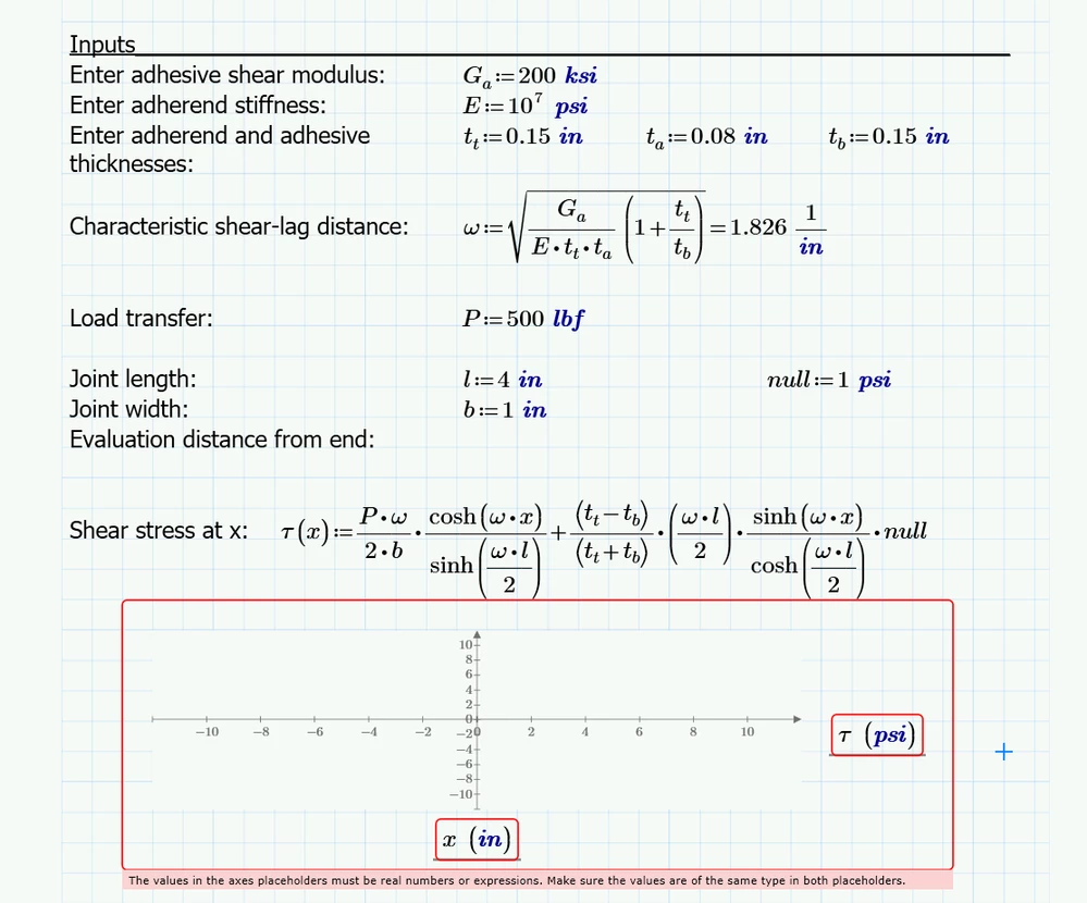

I'm having some difficulty making a simple 2D plot.  Deleting all units permits this to be plotted, but I can't find the error when I do have units introduced.  I tried making a range variable, with no success.  I bet someone can take a glance at this and point out what I've done wrong pretty quickly.
Best answer by ValeryOchkov
Do please before the graph plotting
x := 1 in, 1.01 in..10 in
for example!
And send please the Mathcad file!
