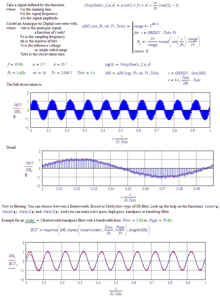

Consult the Help system of Mathcad, I'm sure there are some nice examples.
But they may be in an e-book called 'signal processing', which should also be accessible through the 'Help' menu..
June 8, 2019
Something like:
