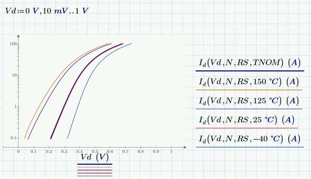

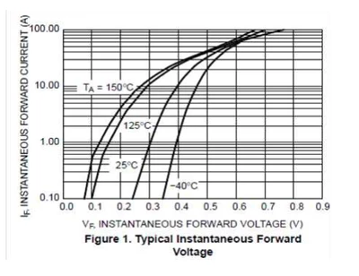

I am trying trying plot the I/V curve on the graph of the diode model, having as example from "Simulation on Mathcad the SPICE Model of the Diode Dmbr2045mfs.pdf" by Pedro Vitoriano.
an somebody help me?
Thank you.

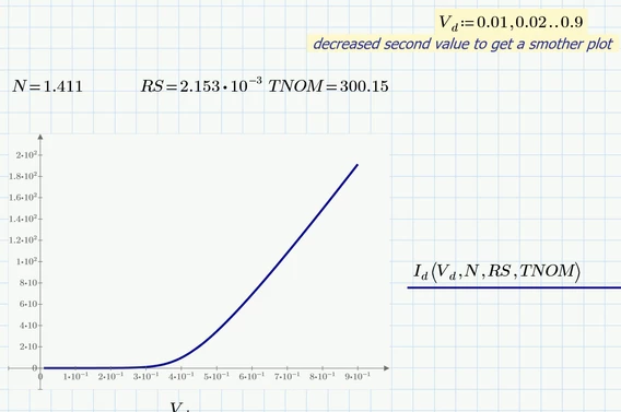

Oct 2, 2025 3:20 PM UTC
You may be used to using square and curly brackets for structuring, but in Mathcad, please only use round brackets for this purpose. If you type square brackets, you automatically create a matrix, which is not what you want here.
1) So replace the square brackets by parenthesis (or omit them entirely, as is sometimes possible in your sheet).
BTW, is there any specific reason why you used "t1" as name for the formal function argument and not simply "t"? Anyway, the name of the formal argument can be freely chosen, I just was curious.
2) In you solve block you wrote IS(t), but IS is a constant scalar (0.0003) and not a function. I guess you meant Is(t).
3) For plotting its better to use range with smaller increments to get a smooth plot

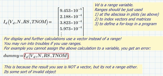

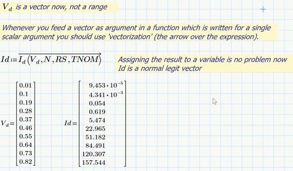

4) For displaying values and possible further calculations with them you should not use ranges but rather vectors! See my comments concerning the creation of the vector in the attached sheet.
Prime 9 sheet attached
Bogdan_d10-MarbleAuthor
Oct 3, 2025 6:41 AM UTC
As mention in older versions of MathCAD (MathCAD 15), from what I remember square bracket have been consider as simple brackets not matrix. OK understood this topic, different version, etc. I am not working daily in MathCAD, not even not monthly.
SPICE model for components are coming without dimension, my porpoise was to make it to work and then to add the units.
t1 no reason, was a copy from the original document mention above.
The final graph it should look like this or at least this was my end results looking for:
Nevertheless thank you for you response and help

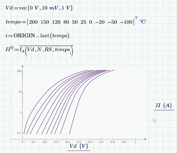

Concerning the plot you would have to use a log scale on the y-axis and manually type in 0.1 and 100 as lower and upper limit.
The result nonetheless does not match exactly the picture you posted. So either other input values were used or other formulas.
Here a pic from the version with units which I posted
or using a waterfall plot
