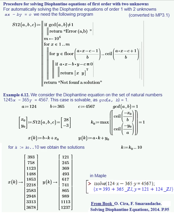

September 27, 2017
@vlehner wrote:
So in summary i have to programm a routine because of the fact that there is no special function in MP4 for this.
THX anyway.
File in Mathcad Prime 3.1 format attached.
