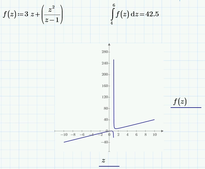

The only way I know to get a numerical answer is to add an = sign at the end of my symbolic evaluation started by -->. Is there any way to skip that step and have Mathcad directly solve my problem numerically? I'm doing some nasty integrals right now and I don't need it to solve it symbolically if it will take forever.
Thanks!
October 11, 2017

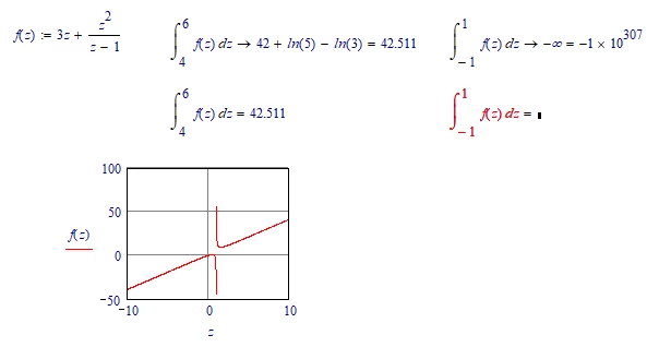

If you only need an answer at the end, maybe the integration operator (Ctrl + Shift + I ) will do:
October 11, 2017
I think it depends on how 'nasty' your integrals are, and where the integration limits lie with respect to the nasty parts of the integrand or integral.
October 24, 2017
Please provide an example.
