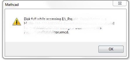

I have a strange problem that I am not able to identify. It is a system problem, not a technical question about Mathcad.
Nevertheless maybe someone has experienced this and can help.  I have already re-booted my PC.
It happens in Mathcad 15, not in Prime.  When I try to save, I get:

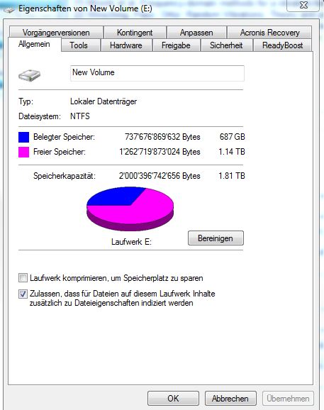

my Disk E: is not full!
If I save on Desktop and then move the file to the target directory, it will be saved there ok.
The problem happens now for many Mathcad files in that directory (but not for all).
thanks for any hints
Regards
Claudio

what kind of disk is your E: ?
  • is letter E: assigned to a partition created on your local disk ?
-OR-
  • is letter E: assigned to network share ? what operating system is installed on file server ?

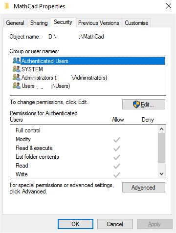

You might want to check the 'rights' you have in the specific directory (a Windows thing, not Mathcad specific). It could just be that you are allowed to write new files, but are not allowed to modify (overwrite, append) existing files...
You check your rights by viewing the 'properties' of the directory, then select the 'security' tab. Here's an example of a directory that happens to be named "Mathcad":

Hi Luc
I did not think of that, now the condition is fulfilled, but now it is anyway not a problem anymore.
BECAUSE: after about 1 hour (I had the time to demonstrate the problem to colleagues and to IT), now I can save. With original name.
I do not understand. But I'm happy it works again.
I'll check your suggestion if it happens again...

I am also thinking in that direction, likely an Antivirus-Scan that is remotely started on my computer from IT.  I have also AcronisBackup but it was not making anything at that time (I did think about this possibility). The E: disk is not network, is local and internal to PC (not an USB-external disk).
