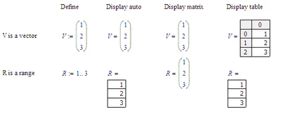

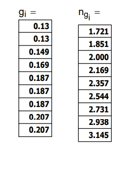

Is it possible to assign the subject of the matrix on top (as Mathcad 15, first picture) instead of on the left hand side (as Mathcad Prime 6.0, second picture)? Thank you for your help.

a follow up question still this form of presentation can only be transfer manually right it is not automatic. For example if I change the formular of nkri it will not change in the table unless we do the changes manually again.
November 16, 2020
Prime tables are for input only. You cannot use them for display of vectors, matrices or ranges.
Also note that the 'variable on top' display that Mathcad (15) allows is for range variables only. mathcad will not display a vector that way.
It is important to know the difference between a vector and a range!
