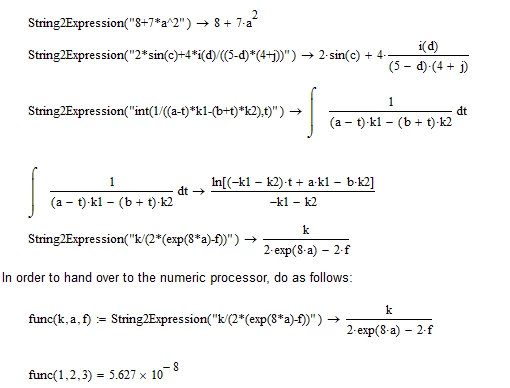

November 6, 2017
As said, the expression (variable or function) to string conversion is not available in Mathcad, although it has been asked for.
The other way around was found over 10 years ago , but only works in mathcad 11 (not before, not after).
This is what it can do:
That way you can even import an expression contained in a string from excel, and convert it to a mathcad expression.
