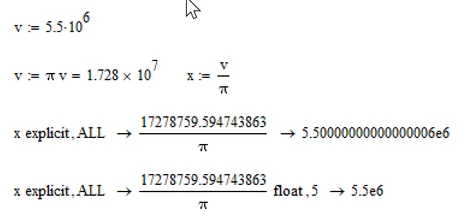

Results are formated as scientific like 5.5x10^6. But when I using that value in equation w/ expicit it is looks like 5.4999999999999995E-05.
My professor rejected to check my work with this formatting in equations. It is unreadable and one value could take half of page. Sadness.

"explicit" is a command for symbolic evaluation and when it comes to float numbers, the symbolics defaults to 20 significant digits and what you see seems to stem from round-off errors during calculations.
The best option is to avoid symbolic evaluation and use numeric one, but if you can't do without "explicit" you may combine it with the command "float", where you can specify the number of significant digits. You have to be careful with "float" because it not only affects the display of the result but also the precision of the calculation.

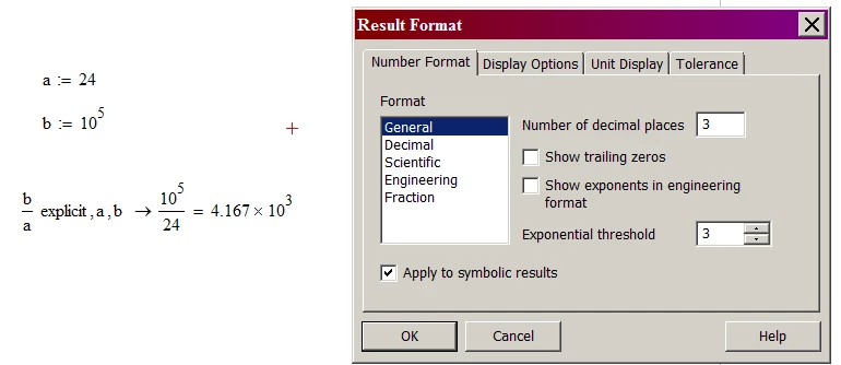

Not sure if you are using Prime or if you use real Mathcad (V.15 or below). With Mathcad you could  apply all formatting you have available for the numerics also to a symbolic result.

Mathcad 15 will let you format the symbolic results:  Pull down the "format results" menu and check the box:Capture.PNG
Then right-click on the expression and you can modify further:

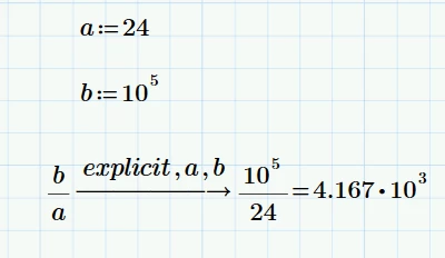

Capture2.PNGIn Prime, you get:Capture3.PNG
