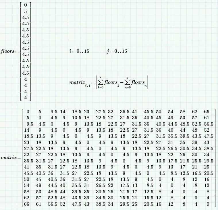

Hi Guys,
I'm new here and fresh with MathCad. I would be very grateful for help. I need a help with creating a matrix (15x15) which indicates distance between all floors. I have a table with height of each floor. Any suggestions?

Hi
Does this look OK

terryhendicott
Aug 20, 2022 9:20 AM UTC
Hi
Does this look OK

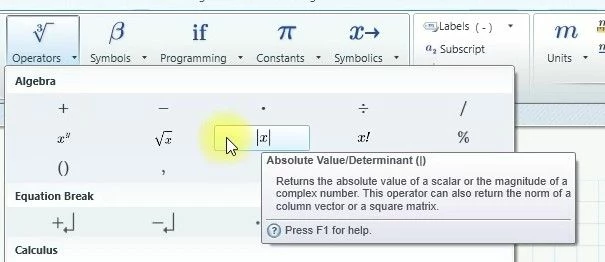

Sir
Thank you very much for help. What exact function are those two vertical lines on sides of summation signs? Instead of just copy and paste, It would be god to understand the whole process.
The vertical lines are to take the absolute value of what is between the lines
The file with the calculations has been uploaded not just cut and paste
