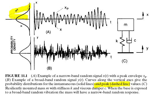

this time I am struggling in order to find the distribution of peaks in a random signal (actually a vibration).  The theory says that the distribution of peaks (not of the instantaneous amplitudes!) can give interesting informations on the type of signal. And be used for fatigue evaluation. See for example the following excerpt from Harris-Shock and Vibration Handbook.

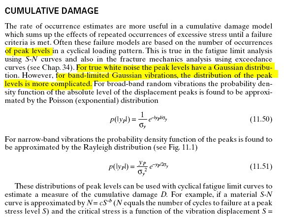

So if a have a very long file with sampled data (for example 10E3, 10E4 points) with a good enough sampling frequency, I could think to try to determine numerically the following distribution (also from Harris-Shock and Vibration Handbook)
