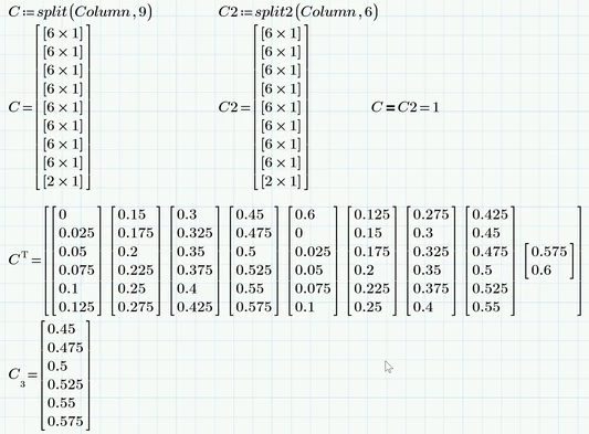

Here is a utility function which splits a Matrix into n smaller ones
and here is the same again with the difference, that the second argument is the maximum number of elements per smaller matrix.
To split your matrix with 50 elements into two smaller ones with 25 elements each you would either use split(Column,2) or split2(Column,25).
Here are other examples
No error checking implemented (n larger than number of rows in M, negative or floating point arguments, ...)

Thanks for letting me know that there is a function to split a matrix. I was not aware of that. It will be really helpful for me to know in future problems, but I was looking for a different sort of solution. Or maybe I was not clear with what I wanted as a solution.  I was able to work through it and solve the problem using for loop. Here is the screenshot of what the loop looks like. It divides the one column matrix into 2 different matrix with same number of elements.
if you look at the two "split" functions I posted you should see that they are doing exactly what you demand, just, more generic and not limited to just two smaller matrices.
Try sol1:=split(D,2) or sol2:=split2(D,25) and you will see that both sol1  and sol2 are identical to your solution.
