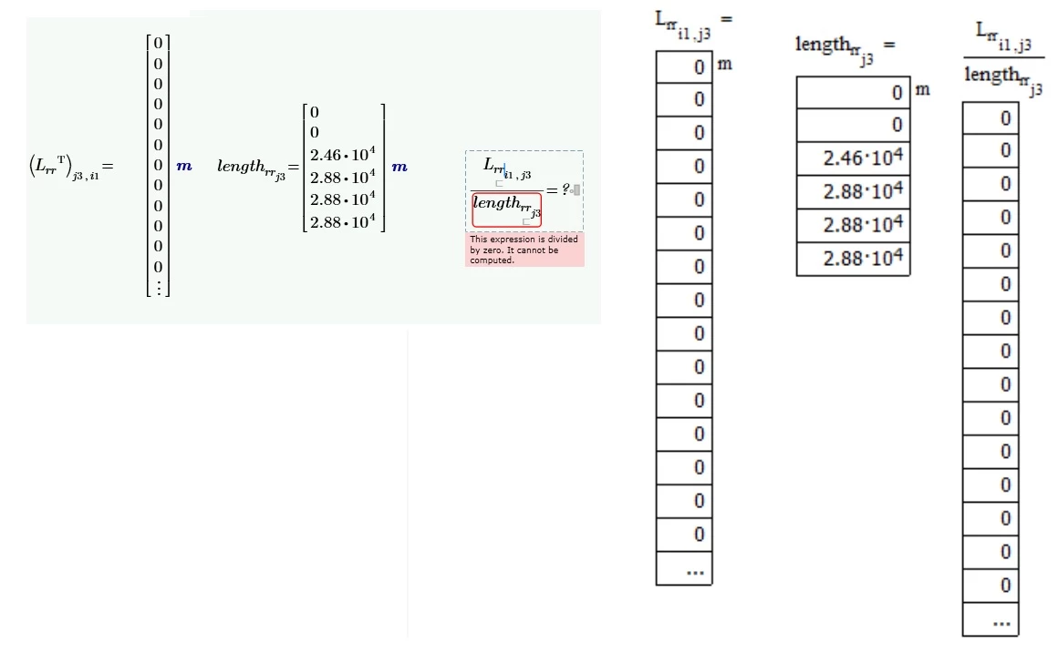

I am converting Mathcad 15 files to Prime and I encounter an issue that I can't debug. Its about a division between two vectors where the divisor has zeros in it. Prime shows the following error: This expression is divided by zero. It cannot be computed. While Mathcad 15 has no problem with this division.
I attached an image to illustrate the problem.

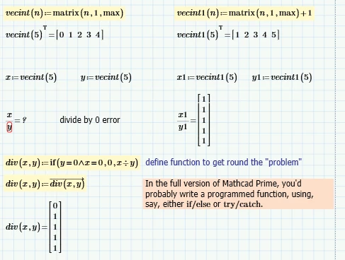

It's been a long time since I've used Mathcad 15, but IIRC, there's an option somewhere in the settings to set 0/0 to 0.  Mathcad Prime doesn't, AFAIA, have such an option.   You'll probably have to define a function to automatically handle this case.
I've only got the non-trial Mathcad Express 7, which doesn't allow programming.  Hence my double-expression definition of the divide function.  The first line handles the 0/0 condition, and the second line calls it using the vectorized operator to make it behave like the / operator (you can't apply the vectorized operator to an if 'function').

That was it! I didn't know that Mathcad 15 could consider 0/0 as 0. I applied a try/error function and it worked.
