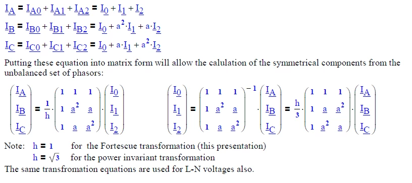

Look at this web page.  Has simple matrix equations for Fortescue Transformations.
https://au.mathworks.com/help/physmod/sps/ref/symmetricalcomponentstransform.html
Cheers
Terry
August 21, 2021
The following listing with examples in Mathcad may also be useful to you.
