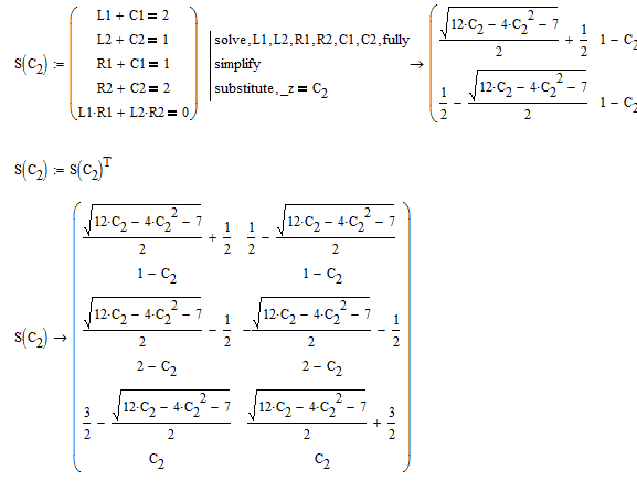

Here is a selection of solutions (the argument ist C2 as Mathcad choses the last variable to be the free one)
You get a set of two solutions for every value of C2 and if you are only interested in real values, you may chose C2 in the range of approx. 0.79 to 2.21.
Obviously there are no more integer-only solutions than the four given in the pictures, two of them include a zero vector (either l or r).

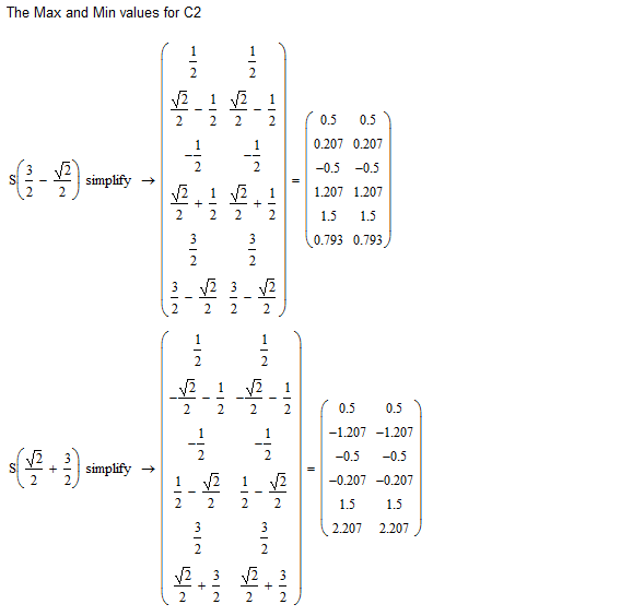

lvl10720-TurquoiseAuthor
20-Turquoise
Jul 28, 2015 3:20 AM UTC
Many, many thanks, Alan and Leopold. I got it. ...
   ( Mathcad 14)
        Loi.
