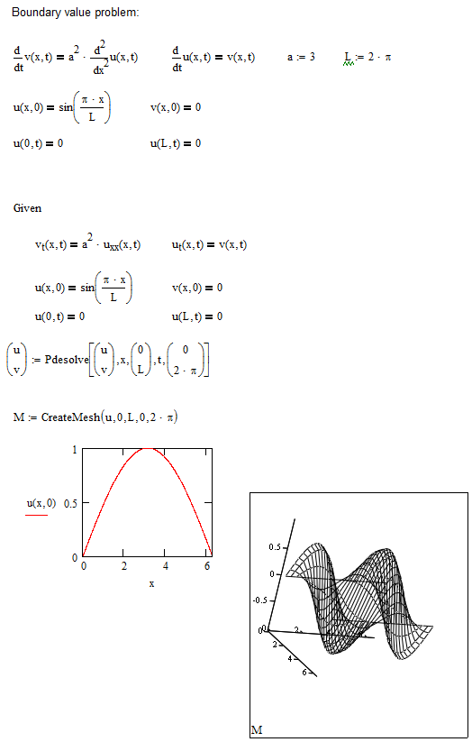

Does Mathcad 15 allow some form of use of PDESOLVE to solve two coupled PDEs?
I have already produced an acceptable finite differences approach in Mathcad, but it should in principle be a lot more laborious than using the PDESOLVE block successfully for the two equations (temperature and concentration). I have used Pdesolve just fine for single PDEs in the past.

I'd guess so. Here's an example from the Mathcad 11 handbook:
glarsen-31-VisitorAuthor
March 3, 2016
Perfect! Thanks, Luc. I just had a minor syntax issue in the very last line (the "Pdesolve..." statement), and the example clarified it.
