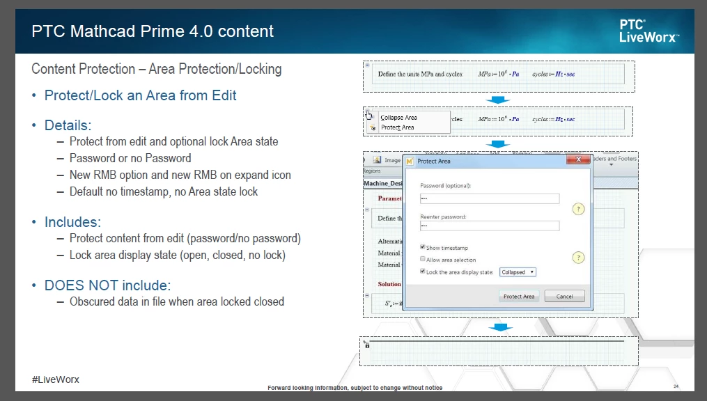

I guess request no.1 is planned for Mathcad Prime 4.0. Two others are not implemented.
MH
December 12, 2016
In the future Mathcad Prime 4.0 release you can only set a password for hidden areas (more about Prime 4.0 planned feature here: PTC Mathcad Prime Roadmap (2015/2016 update) 😞

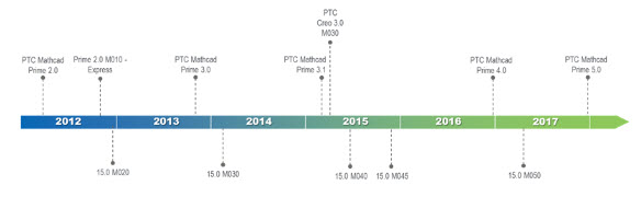

December 13, 2016
So, according to the schedule 4.0 is due this week, or maybe next week at the latest.  Should I hold my breath or expect another 6 month delay?
December 14, 2016
According to the latest information Mathcad Prime 4.0 planned to be released end of December 2016 year.

Mathcad 15 allows you to lock hidden areas.  As noted by others, Prime 4.0 is supposed to include this feature.
The other two requests would likely need to be filled outside of Mathcad.

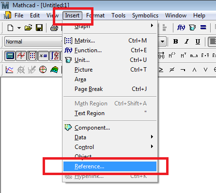

You can insert a link on a document containing data (but as I remember here the address with "https" not working) by select "Insert" --> "Reference":
