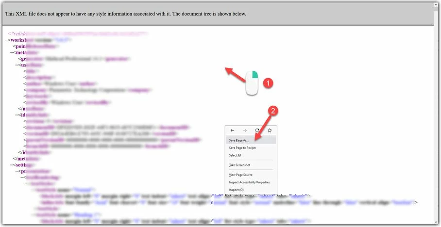

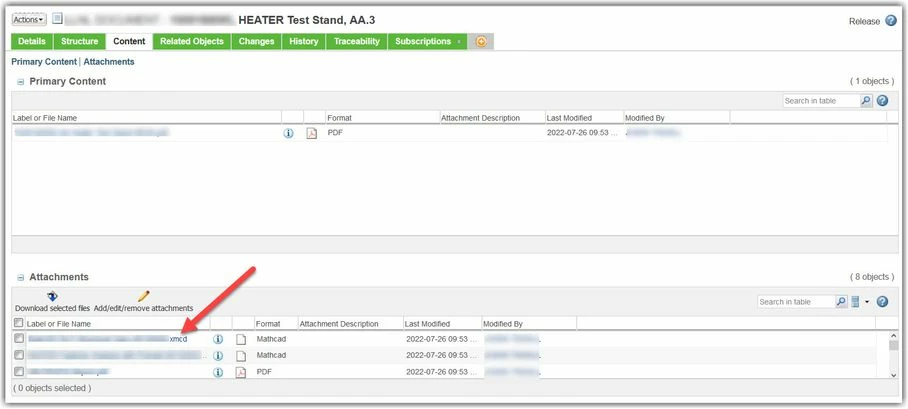

Here is the solution that we have discovered, and it works great!
  1. In Windchill on the content tab of your document object, Click on the “Label or File Name” of the File you wish to download:
     2. Right click on the page in the browser > Select Save Page As…
     3.  Change the Save as type to All Files (*.*)
     4. Remove the .xml extension. In Firefox the existing file extension (ex .xmcd) will be there in the File Name however in other browsers this may be missing, just make sure the file name ends with .xmcd > Click Save.
