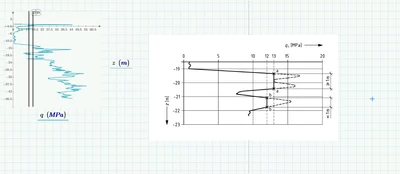

Drawing a graph in mathcad
Hi there
It has been days since I started working in this task , but couldn't reach the right result
I need to draw this graph in mathcad
I have two values >>
z ( depth a reading taking each 0.02 m )  so in one meter we have 50 z-values
and qc ( resistance in that  z depth)
I need to write a program that will choose the minimum values of ( q , 12 MPa ) if  change through z depth in one meter is less than 12MPa
and the minimum value of of ( q , 15 MPa ) if the change through one meter is bigger than 12 MPa
the sheet is attached

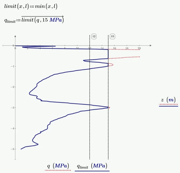

So here is attached a first try.

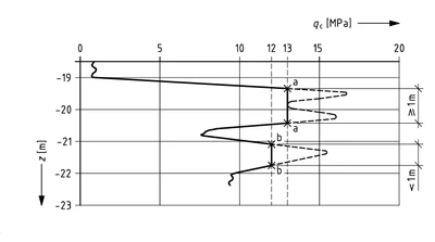

What does this mean?
What's the exact algorithm?
What should happen, if the red distance is larger than 1 meter, but the green is less than 1 meter?? Is the limit 12 or 15?? And why is it that way?
What, if there is part of the curve between 12 and 15 in this case (drawn in blue)?
Hi Werner,
Let say the whole depth is 30 meters and z is a reading taking each 0.02 m for qc ... so I want to check the values in each one meter (1 m)  so I will be checking 50 values in each step .
1) We consider 1 meter as a constant height  to check the values
First  : I will see the values in one meter if they are bigger than 12 MPa , than choose the minimum value between ( qc and 15 MPa)  not the 12MPa ... it may be 13MPa or 14MPa
Second : if the values are equal  smaller than 12 MPa than choose the minimum value (qc, 12 MPa )
for this question: What, if there is part of the curve between 12 and 15 in this case (drawn in blue)? choose the same value ( not 12 MPa and not 15 MPa ) if it is 13 MPa so it will be 13 MPa
I hope this makes it clear
Unfortunately not for me 😞
Its not clear, if the check is done just 30 time (range from 0 to .1m; from -1m to -2m, etc.) or if the check is to be done from each z-value down to z-1m.
And from your new description it looks like you simply have to limit all values to 15 MPa, because
if all values in this 1 meter interval are <= 12 MPa, then ther would be no need to limit them to 12 MPa.
Did you mean that the maximum value in this 1 meter interval is between 12 and 15 MPa rather than <= 12 MPa?
I guess you don't mean "the values" but rather " if just one value of the 30 values...", correct?
So I wonder in which case you would like to have a limit of 12 MPa!? From  your new description - never?!
I also wonder the reason for that 1 meter interval - as i see it limiting all values to 15 MPa would do the same job much easier:
Here the first 5 meter
