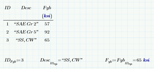

To achieve this in Prime, you could create a table of the possible selection options and an ID number.  The user would then enter the ID number for the selection of their choice.
Note that I changed ORIGIN to 1 for this example.
If you want to maintain a look similar to your existing file, you can place this table in the non-printed region.

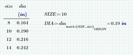

Here's an example where the user input is not the vector index:

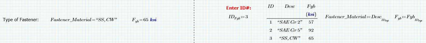

Alternatively:
