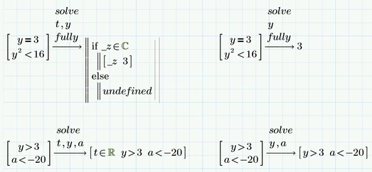

I've seen a couple of PTC articles showing a symbolic solve block using a 'dummy' variable in the solve variable list (which isn't represented in the solve expressions).  The examples involved inequalities.  They use  't'  and it appears needed to force a comprehensive result.  I attach a file with two examples.
Does someone know the intention, and interpretation, of this dummy variable?

What those examples show is that the legacy symbolic engine (muPad, last Prime version it was included with was Prime 6) most of the times refused to solve for a variable which does not appear at all in the given equation or inequalities, while the new (but still less capable) engine gives a more or less meaningful result. Actually a variable not being present in any of the given equations or constraints can take any value you like - it  does not make much sense solving for it IMHO.
Fig. 37 shows that in this case the legacy engine returns a wrong result (its also inconsequent that is returns here a result because of the unused variable t solved for), while the new engine returns a correct result.

but back to "solve" and the dummy variable t. I could not see a single example for its use where it would be needed for something useful ( actually I don't consider solving for a non-existing variable to be useful).
Fig.36 shown an inconsistency in the new engine, The doc says (and many example prove it true) that the new engine assumes unknowns to be real numbers unless otherwise stated. consequently in Fig. 38 it returns t element of R. So why in Fig. 36 it says _z in C ? This is a result I would expect from the old engine as this engine assumes all variables being complex unless otherwise stated.
@LucMeekes wondered why Prime suggests t=0 in this example
but this is a well known behaviour also present in older Mathcad version, that the symbolic would just return one single solution in some cases where an infinite number of solutions exists.And for a single solution t=0 might be as good as any.
Often the symbolic can be talked to give all solutions by using the "fully" modifier
and it sure is not wrong to add a "simplify"
To see "t" instead of the generic "_z" you can use the "substitute" or "using" modifier

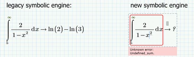

Talking about differences between the new symbolic engine and the legacy one. Here some examples you won't find in the comparison pages by PTC 😉

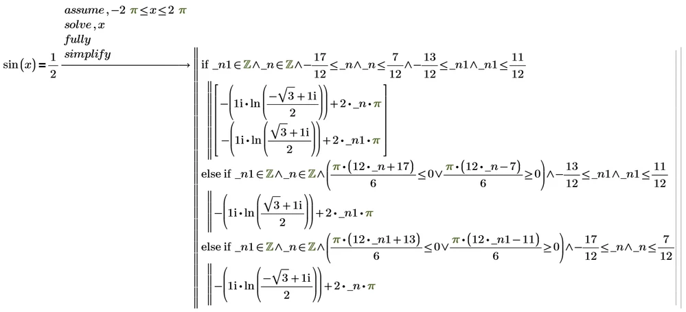

You would also get just one single solution if you ask for sin(x)=1/2 to be solved
and adding "fully" gives you all of them
Here the simple and clear result of the old legacy engine
and here what we get from the new engine
it either ignores the assume modifier
or it presents us with a, lets say very unclear expression if we again add "fully" (and "simplify" does not really help)

As I see it it has no mature effect when using with the new engine and I see no reason why you should use it.
The examples in the help pages simply show that the legacy engine sometimes refused to solve an equation if that unnecessary and nowhere existing variable was in the list of variables to solve for.
