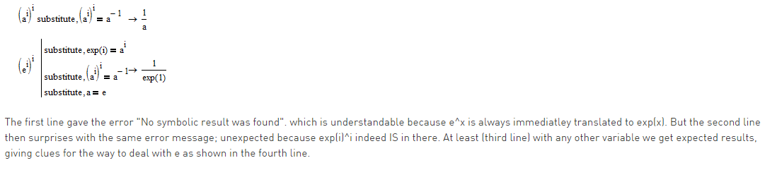

I think it's a quirk of the Mupad symbolic engine.
In Mathcad 11 the (Maple) symbolic engine produces the following quirky output:
It appears that e or the exp() function has a special meaning:
The first line gave the error "No symbolic result was found". which is understandable because e^x is always immediatley translated to exp(x). But the second line then surprises with the same error message; unexpected because exp(i)^i indeed IS in there. At least (third line) with any other variable we get expected results, giving clues for the way to deal with e as shown in the fourth line.

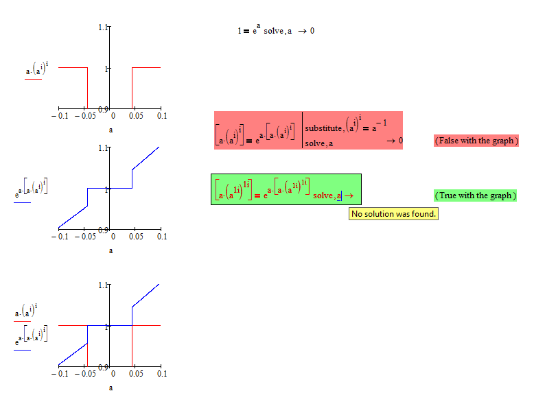

  It seems my Mathcad 14 don't work (accept) with:
because :
furthermore :
and I wish learning,wish having your help in Mathcad 14.
