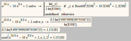

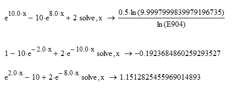

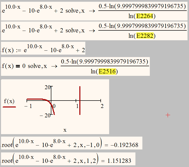

Can anyone explain what the meaning of those changing E-Numbers could be?
They change whenever the sheet/expression is recalculated, so I suppose this to be some internal variables of the symbolics engine which should never show up, right?
Doing a manual sybstitution Mathcads symbolic is able to find the solutions.
