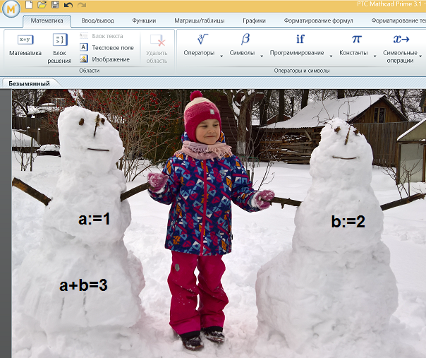

"Format Tab": you are referring to Prime...
In Prime there are no provisions for setting background colour of the sheet as a whole. A suitable location would be under the Document tab....

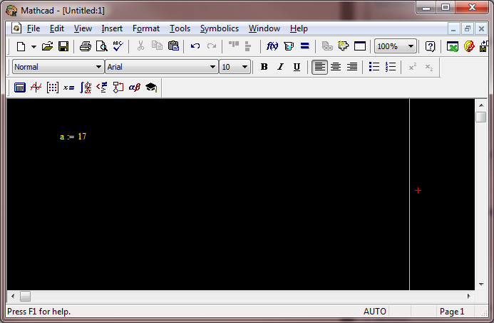

In Mathcad 11...15 it is possible:
success!
