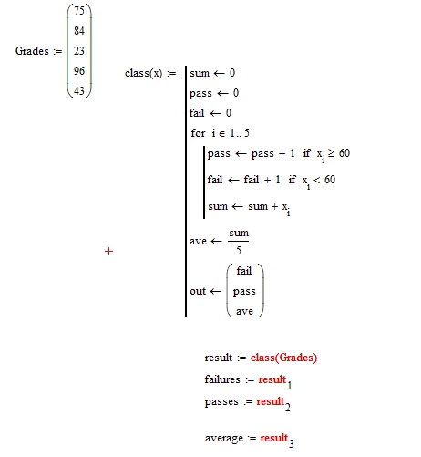

I am very beginner user for MathCAD 15.
I have a trouble that I cannot solve myself.
What am I doing wrong in this code ?
Its hard to debug a picture - you'd better had posted the worksheet itself.
Best guess is that you have not changed the default value of ORIGIN, so its still zero (which is a good idea anyway) but you used a range from 1 to 5 to loop through your vector Grades. Vectors are indexed beginning with the value of ORIGIN, so by default for a 5 element vector this will be 0 to 4. So the usage of 5 may have thrown that error.
As Moe has already shown the task can be acomplished in a much simpler way. If you prefer the functional approach, you may use this:

There are actually three summation symbols in Mathcad.
One following the usual mathematical convention with summation variable and lower and upper boundary, the second with only a placeholder at the bottom which should be filled with a range variable and the third without any placeholder (other than the one to hold the expression to be summarized). I used the latter which is to be used to sum up the elements of a vector.
The argument x of the function class has to be a vector of grades. x>=60 creates a vector consisting of 1's and 0's, depending on if the condition is true or not. The sum of this vector therefore gives the number of students having passed the test.
rows, cols, last are predefined Mathcad functions which work on vectors. Look it up in the help. The help in Mathcad is very useful - give it a try.
