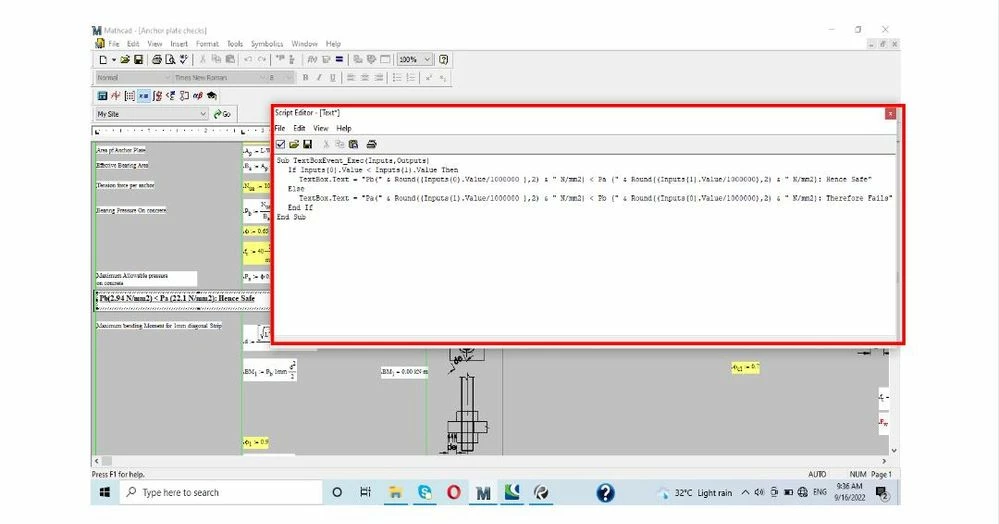

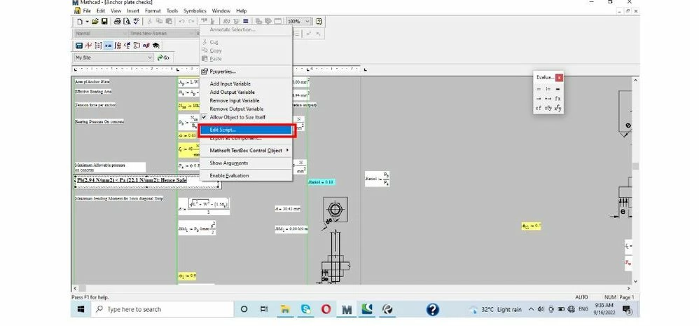

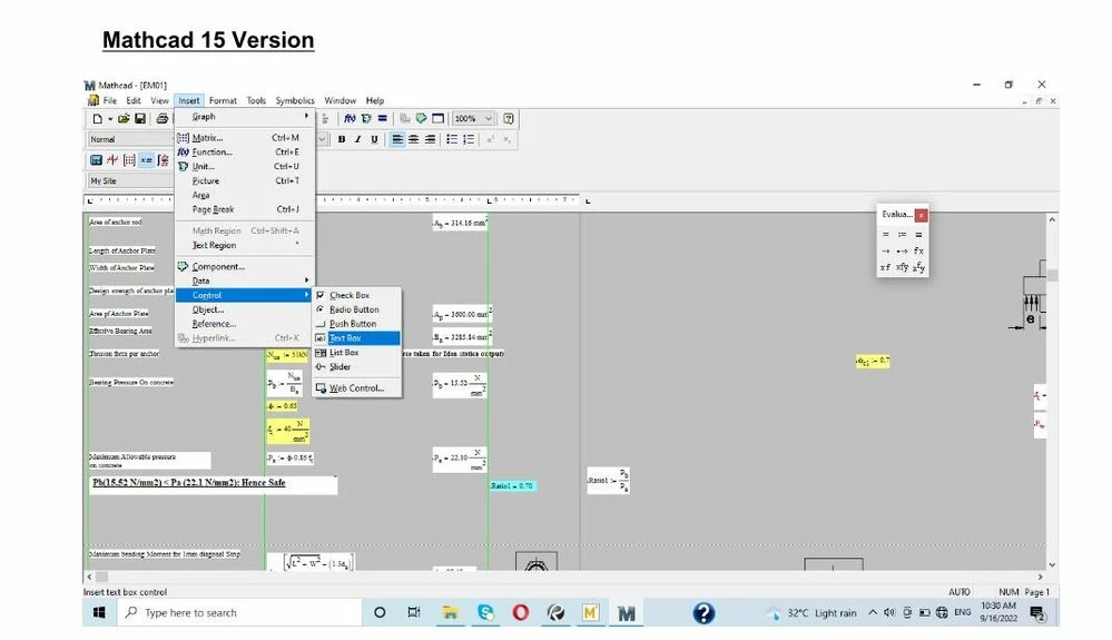

Hi ,
Kindly suggest where to find the Edit script( script editor ) option in Mathcad prime 8; which was earlier available in insert menu under control tab in Mathcad 15
Have attached images for reference below

Correction: Scripted controls are scheduled for Mathcad Prime 10, which should be March 2024. The working group has been created at the beginning of this month to allow for enough time for product management to get feedback and enough time to develop that in the product. (Prime 9 wouldn't be enough time.)

Scripted components are not available in Prime 8.
There is currently a working group to determine what form scripted components exist in Prime 9.
Prime 9 is earmarked for march 2023

Not really.  Only programming opportunity is the Prime API that can read out of and write values into Prime.
It is available to a number of languages.  A running application in the language of choice gets Prime to work unlike a script that Prime would run..

Only way is to push this request up on the wishlist ladder by voting for suggestions; see here Conditional formatting of outputs - PTC Community
