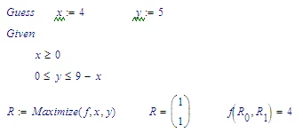

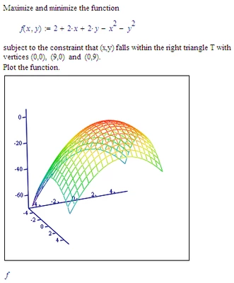

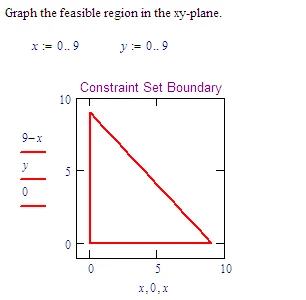

Here's an example (of a former Mathcad), that you should be able to build in Prime to gain experience, and then you should know what to do to rebuild your system for optimization:
Now comes the solve block:
