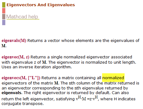

Can someone please explainwhich eigen vector mathcad has gave me as there are infinite number of eigenvectors?Eig+Vals+and+vecs.png

1) For future questions please attach your worksheet, too.
2) Looking up a command or function in Mathcad's built in help is not that difficult and it doesn't hurt either. So use the help, study the quicksheets, etc. - you will benefit from doing so.
3) The above does only apply to numeric evaluation. Mathcad's symbolics (MuPad) has a different approach:
