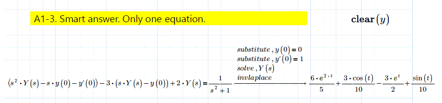

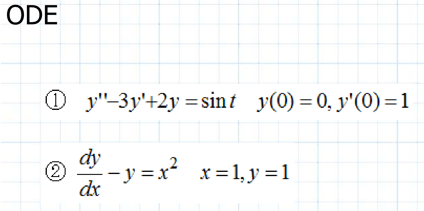

Is their more smart way to solve ODE question No. 2 by Mathcad Prime 4.0?
My answer is attached.

@ttokoro wrote:
Problem 1 can solve only one line.
Is problem 2 also can solve one or two steps?
 How about this, using time shifting:

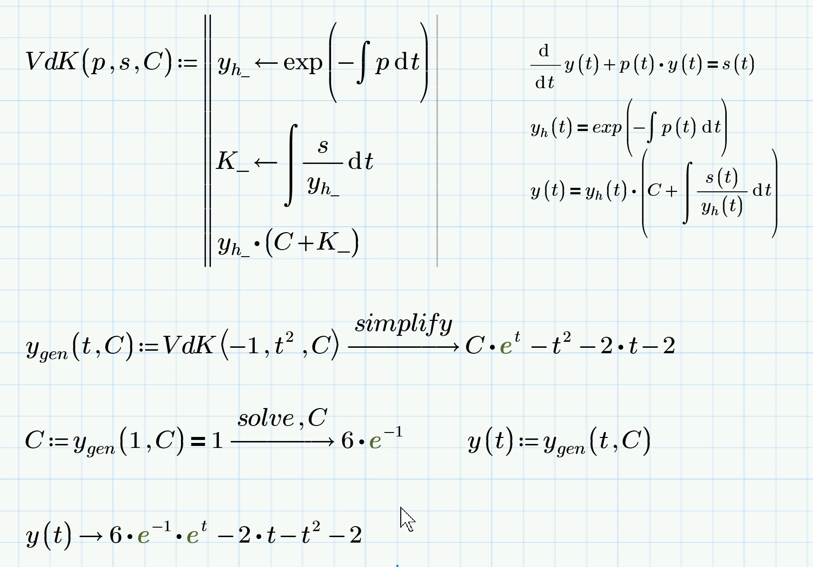

For the ODE of first order maybe a utility function like this:

Werner_E25-Diamond IAnswer
