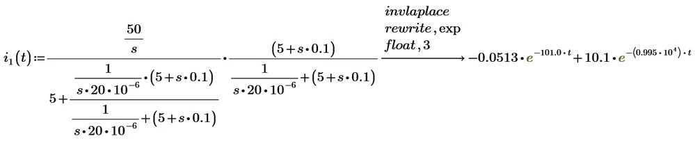

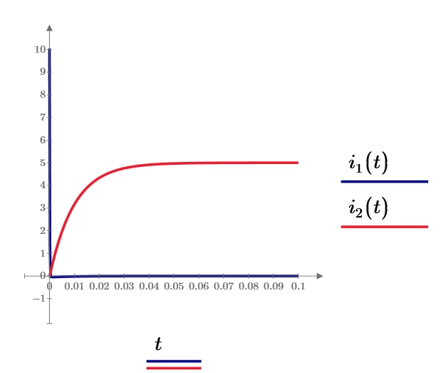

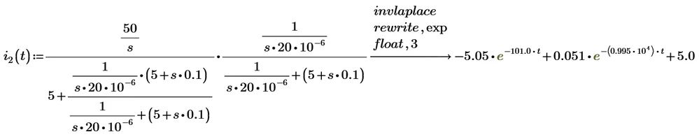

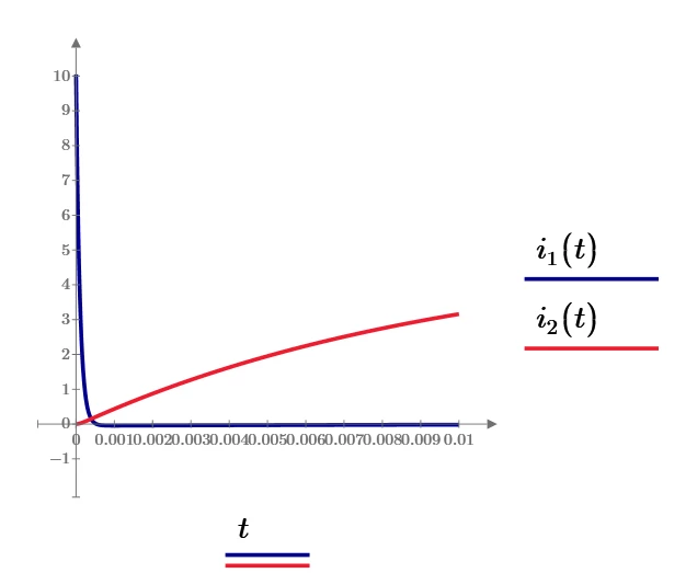

P.139 Text Book answer is right.

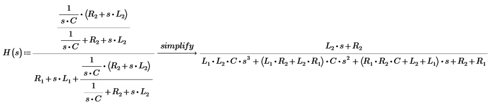

P.141- Solved by only 2 equations.
