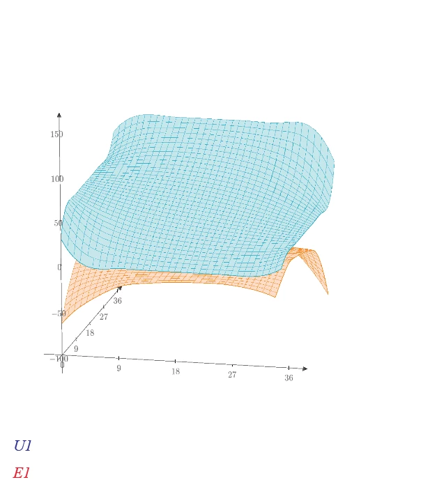

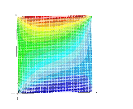

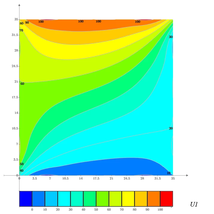

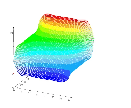

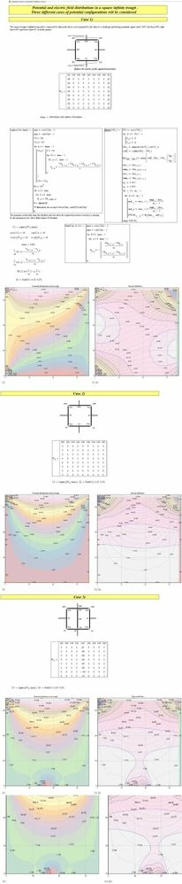

I have a graphics problem and that is: after having determined the equipotential lines (see photo) in a system with a square section and infinite length, made up of metal plates isolated from each other and at different potentials, I do not know how to make the field lines orthogonal to those of the potential. I have fixed two constant values ​​for the increments dx and dy. I attach the worksheet:

Step 0. Convert to Prime 10 and plot them.

Step 1. Make interpolateed data.
Step 2. Trace the field line on the potential 3D plot. It need time for me to solve.
