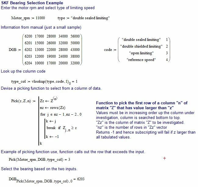

However, what I am looking to do is to create a template for bearings design and sizing on electric motors. The template will allow variables/inputs to be inserted by the user and it to then give an output of what type of bearing should be used (plain/rolling element etc.) for this type of electric motor and what size of bearings should be used.
The kind of inputs I have had in mind are load, motion, lifespan and speed but open to suggestions.

What i would be looking for would be how to basically translate this into mathcad to make it more 'user friendly'. I am looking for this template to be as simple and time saving as possible for the user where a couple of inputs can be inserted and then the recommendation made.

In the bearing manual no calculations are required it is just looking up numbers.
example enclosed.
