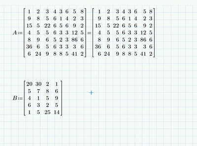

I know it is a long shot. But I hope there is a way to do this. Suppose I have 2 matrix with very different number of rows and columns, say A is M x N and B is L x K. How can I divide each element of A matrix with every element of B matrix and Have it in a form of Matrix.  I am trying few things with nested for loops but have had no luck yet.

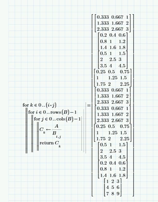

Hmm!!?? But thats quite different from what you answered to ppal where you, too, said that this is exactly what you want the solution to look like!??

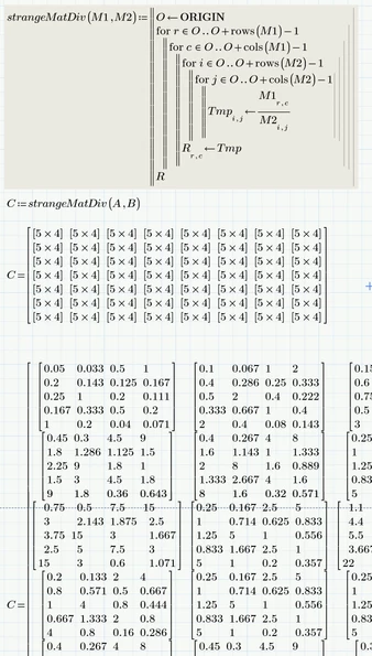

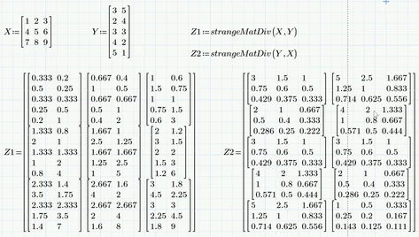

Anyway, here is a function which will create this huge result matrix:
With the matrices ppal used:
18-Opal
Jun 23, 2022 2:42 AM UTC
Like this???

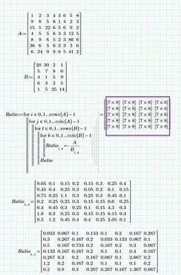

KAL_162510-MarbleAuthor
Jun 23, 2022 4:12 PM UTC

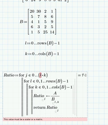

This is exactly how I want my solution to look alike, but for some reason, my worksheet is showing error stating that the variable i and j should be scalar or matrix.
KAL_162510-MarbleAuthorAnswer
Jun 23, 2022 4:26 PM UTC
I actually found a way to do what I need. But it shows matrix within a matrix with just number of rows and columns. How can I make it to display the entire matrix showing up with values. I have to display each matrix using index.

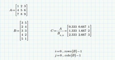

Is this what you intend?
