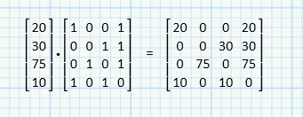

I am trying to achieve something like the below (the equal sign is text only). I'm not even sure if this is mathematically possible however, and may require some manipulation to achieve?

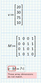

Here is what it looks like when I try to do it
Appreciate any possible help with this, it's been a long while since I studied matrices!

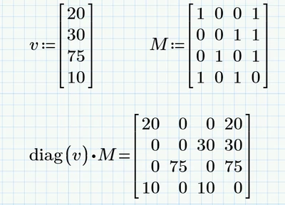

Try using the diag function on v:

Hi Fred,
That is excellent, thank you!
Marked as solved.
