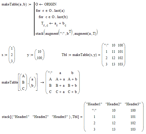

WE & Fred thank you very much for answering the question, specially to WE.
WE, is it possible to get the answer in the following format? Thank you
Header 1Header 2Header 3
ab
AA+aA+b
BB+aB+b
CC+aC+b

Had not seen your previous reply.
Here you are:
February 27, 2017
Not being a spreadsheet, Mathcad is not really good in making nicely formatted tables with headers..
Does the attached help?

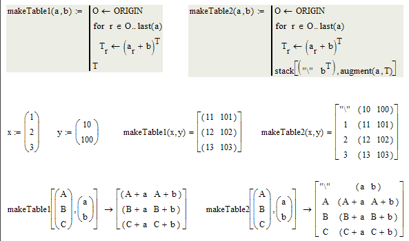

Your are really and expert in programming in Mathcad. Can you address please the final question in my first post. This is  what I wrote back then in my first post
Hi WE, thank you very much for your excellent answer. Since you are asking me I  prefer if the 3X2 matrix would be 3  1x2 matrix,
[A+a, A+b]
[B+a, B+b]
[C+a, C+b]
Your previous two solutions are elegant, but I basically prefer the output as 3 separated matrices as shown above.
Thank you very much.
juan
Werner_E25-Diamond IAnswer
February 28, 2017
Here you are:
