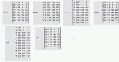

we have so many inputs I need to write a program to tell mathcad , if the input matrix or table has less than 700 rows don't include it in the calculation. Can you help me doing this , please? The sheet is attached .
For example I don't want Mathcad to do the calculation for CPT3 because it has less rows than 700

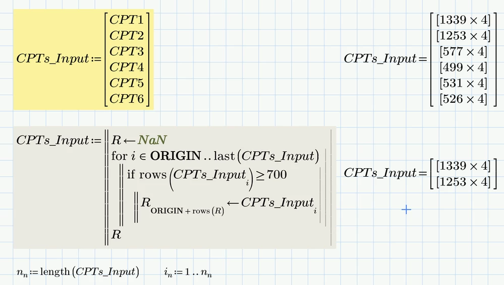

Seems that only two of your six matrices qualify.

What does (Nan) mean? is it constant or variable?
May 15, 2024 12:44 PM UTC
NaN ("Not-a-Number")is a predefined constant.
Its the result you get if none of the matrices qualify because they all have less than 700 rows.
