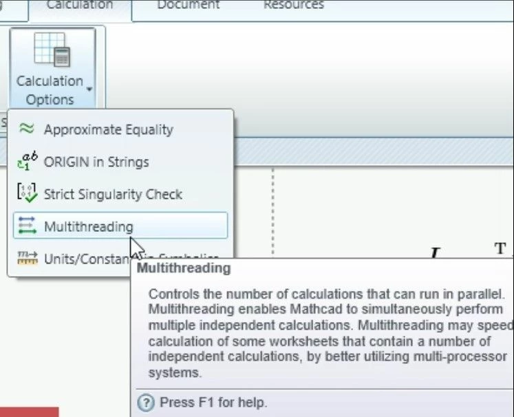

Try turning off multithreading calculations
Raiko17-PeridotAuthor
Jul 31, 2024 6:50 AM UTC
Hello Terry,
thanks for your advice, but switching off multithreading doesn't work.
I've attached the "offensive" Mathcad sheet. It worked before, but since Monday it started misbehaving. Perhaps it is due to our companies switch to Win 11..
