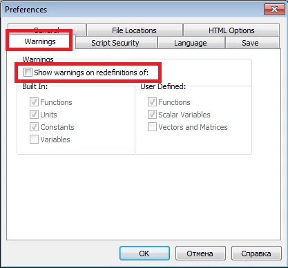

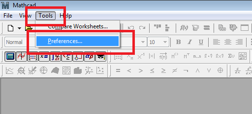

Hi Michael,
In main menu you need to select "Tools" --> "Preferences" --> tab "Warnings" --> uncheck "Show warnings on redefinitions of":
