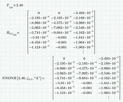

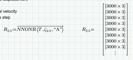

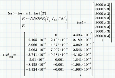

Nov 9, 2023 5:38 AM UTC
You need to apply vectorization (arrow over the expression) when you call NNONR with T as a vector.
But the result will be a vector with 200 elements corresponding to the 200 values in T and each of these elements would be a 3000 x 3 matrix (the augmented vectors u, v and a corresponding to the specific value in T.
You would get the very same nested matrix by looping through T and calling NNONR for every value of T (which actually is what vectorization does)
So I am not sure what you would like to plot ...

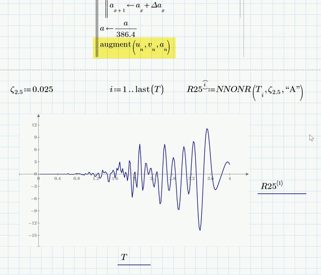

Nov 9, 2023 8:07 AM UTC

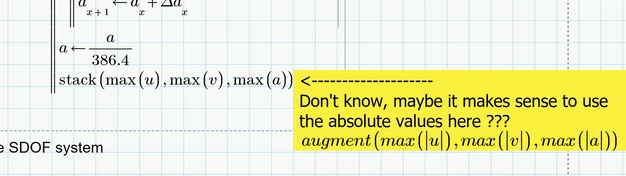

At least the last value in your vector Accn is a NaN. You may filter for them:
I still don't know what you are trying to plot as with the function you wrote you would get 3000 displacement values for every single time T. So which one would you like to plot over time?
If its the last one of all this values you could do it that way
Not sure if this would make any sense, though.

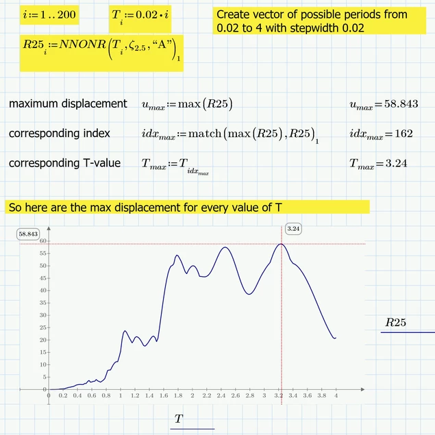

RandyA.EI4-ParticipantAuthor
Nov 9, 2023 8:14 PM UTC
Thanks for all the insights! I guess what I'm trying to do is run the "NNOR" code for each value of T (200 times) then I want to take the maximum value of displacement, velocity, and acceleration of each iteration and store that in a matrix to plt vs. the T matrix.
I'm not sure i that is possible with the amount of data stored in the text file. Would it work if I deleted the back half of the file to where it only stored 200 points of data?
