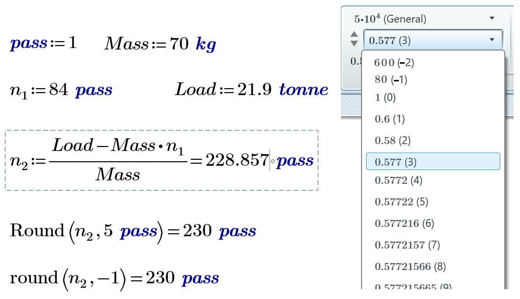

I ask my students give correct answers in reports. One example
But I have seen in one German tram (constructed by good engineers) this table
Why 229 places for stay - not 230? The street car will break with 230 men?
In Mathcad Prime Minister we have

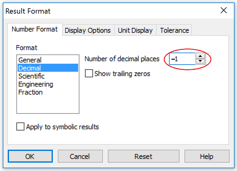

In general, the (numeric) answer to a problem should not have more significant digits than the smallest number of siginificant digits of the input data.
If that is that what your '-1' setting is doing in Mathcad Prime Minister, then it should not be a '-1' setting on decimals, but rather a check box, that applies to most of the formats.

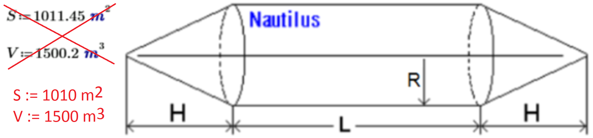

Jules Verne was not an engineer - he was a lawyer with education! More about this problem http://twt.mpei.ac.ru/ochkov/MathLit.pdf
