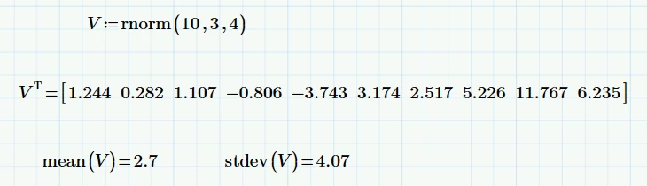

Hello Everyone,
I need to insert some random numbers in table and to do so there was an option in earlier versions of ptc mathcad which is demonstrated in given link -
https://www.mathcadhelp.com/entering-a-table-of-numbers-12248
but right now it is not working in my ptc mathcad prime 4.0. Need some suggestions on how to insert the x values to each point in a defined range.

The function rnorm(n,s,v)  will create a vector of n elements that have a normal distribution about a mean of s with a standard deviation of v.
If all you need is to enter a list of numbers in a vector, cntrl M will start a vector, enter the first number. the tab key will jump to the next row, or "shift space" will move to the next column.
They Prime editor is different from your example, but the functions are all (mostly) still there.

In Mathcad and also in Prime you can use a syntax like x:=stack(1,3,5,-1,2.45) to create a vector with a few values.
In Prime entering a vector an changing its size during editing was made much easier and more convenient than it used to be and you can do it as Fred suggested by pressing Ctrl-M and entering values, followed by Shift-Enter or Tab to go to the next row. If you want to create a matrix you press Shift-space to create a new column. Also deleting columns and rows are rather intuitive and easy and can also be done using the appropriate actions from the menu ribbon.
