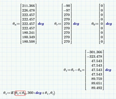

Hello, I am trying to use an IF Statement to check one vector against another.  I would like to return the same value into a vector or an altered value depending on if the one vector's value at a row is above 0 degrees.  I have tried replacing Theta_0 with the value of 0 deg.  Either way I am getting an error that says the value must be a scalar.  Could someone help me figure out how to make this IF Statement function properly?
V/r,
Devin

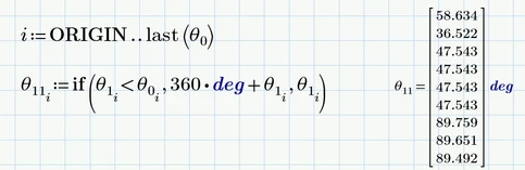

One way uses vector indices to singly apply the if-function to each value

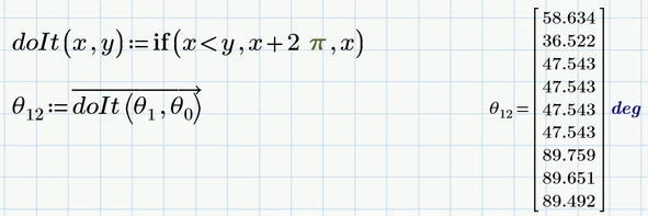

Another option uses a utility function and call it vectorized. While the comparison operation can't be vectorized directly, a function using the comparison operator can be called vectorized.

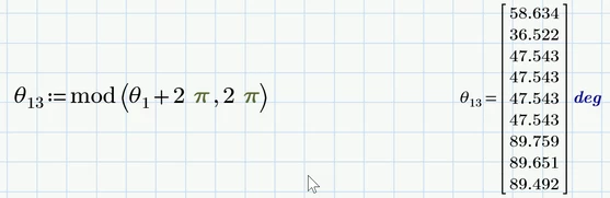

As in your case the goal is just to normalize the angles to be in [0, 360°) you could do without theta0 and use the mod function

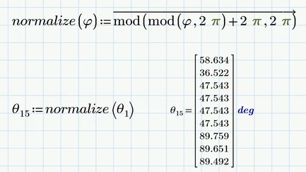

A more generic approach is
which would deal with angles lower than -360° as well.

Thank you very much!!  I will use your first example of theta_11_1.   I appreciate you responding so quickly too!

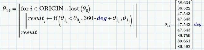

I forgot to mention that if you. like me, don't want you worksheet to be cluttered with range variables which are only used once, you may replace it by a programmed for-loop:

I guess I personally would rather prefer the last method in my previous sheet.
You may define a utility function "normalize" at the top of the sheet, maybe in a collapsed area) and use it later that way
I consider it good style to use vectorization here in case a vector argument is used instead of a scalar, but in case of this function it would not even be necessary to vectorize.
