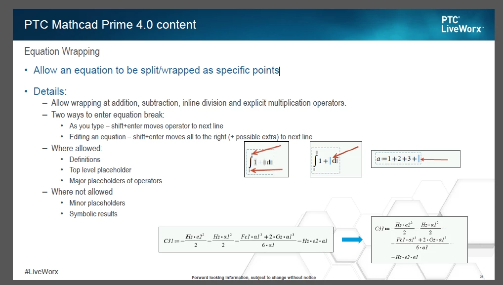

I want to enter a long expression and have it wrap so that it stays within the page margins.
In older versions of MC one could use control-enter to wrap to the next line but that does not seem to work in MathCAD Prime...
Is there a way to create a multiline expression in MC Prime?

not yet.
"promised" for Prime 4.0
June 23, 2016
Equation wrapping for Mathcad Prime 4.0:
