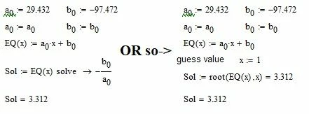

Do it this way:
Though why you think this is less painful than simply setting x:=97.472/29.432 is beyond me!

The calculation proceeds as follows:

March 12, 2020
Thank you!  This is working in MathCad 14.
I am not sure I understand why but at least it is working and saves me a lot of time to type in the intermediate values manually.  I just speculate that MathCad 14 is not perfect so that trying various equivalent calculation options comes up with a working method.

1. You should ALWAYS attach your worksheet, or at least A worksheet that conains the problem. That helps tremendously!
2. You get this weird result most probably because, instead of using the symbolic operators pad, you typed 'solve, x' immediately after 'EQ(x)', which caused a multiplication like
EQ(x)*solve,x
Then you pressed the button for a symbolic evaluation. That results in the answer you get.
Correct this situation (by all means USE THE SYMBOLIC PAD to initiate symbolic operations) and you'll see that it works like you expect it to.

Have you also read Lucs #2) ?
It looks like he found the problem of your expression giving no result.
After all your approach should work as well as Alan's small variation if you use the "solve" from the symbolic palette or at least type Ctrl-Shift-. to get the symbolic arrow with a placeholder and then type "solve,x" there.
