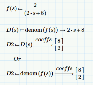

One more thing, I have a fractions like 2/(2s+8), how can I choose numerator or denominator?

Do you mean how do you separate them? Use the functions numer and denom with the symbolic processor.

Hello, yes I mean use it for symblic processor.
For examples, I have 2/(2s+8) then -> denominator -> coeffs.
Like type a function and then use only numerador or denomintar using symbolic expressios.
