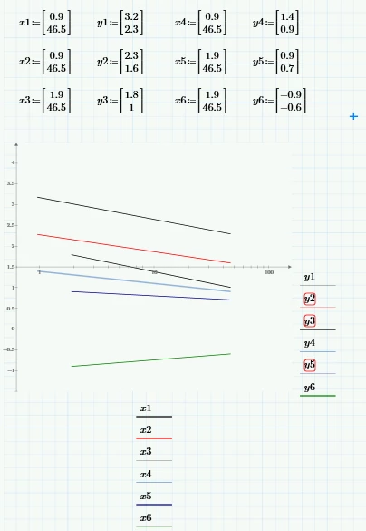

Need some help to create an equation for the 6 cases of  linear graph I attached the mathcad prime for your reference.
 I cannot make the graph straight using  this formula ( y= mx+b)  because x  should be   in  logarithmic  distance

ldante,
The equation is y=m*log(x)+b
For x1 & y1, this can be found to be y1=-0.52532*log(x1)+3.17596.

Hi Lex,
It's not completely clear what you want...
What you have is y=m*log(x)+b.
If you solve m and b in:   y1=m*x1+b
you get m=-0.01974 and b=3.21776.
You can do the same for the other sets.
Does this help?
I think OP is looking for your equation y=m*log(x)+b.
If you solve for m & b in  y1=m*log(x1)+b
you get m=-0.52532 and b=3.17596

Yes .. I need an equation . I am using  logarithmic scaling in x axis  .  Thank you in advance  🙂
