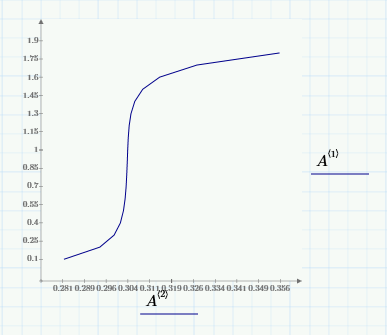

Equation From a graph?
Hi.
I want to know how can I get the equation from this graph

Valentin,
You cannot get 'the' equation, but it is possible to get an approximate or best fit, provided that you have the data points.
Look up 'curve fitting' in the manual or help section of Mathcad. Focus on functions like regress() or any of the xxxfit() functions.

As far as we can see from the screenshot provided, Valentin does not need to digitize a plot as he already has the coordinates of the points in the matrix A. What he wants to find is an equation.

Please attach your Mathcad Prime worksheet.
November 12, 2013
You won't get THE equation. All you have is a number of points, so there are an infinite number of different equations possible. One of them could be a polynomial of n-1 th order if you have a datavector of n points. But of course you can also find logarithmic, exponential and other types of function or combinations of them which include all of your points. You have the choice between exact interpolation or approximation.
As valery wrote - attach you sheet, show what you have done so far and tell us as precise as possible what the intent is.

From the screenshot Valentin provided it seems that he already has his points, he is searching THE(???) equation, not digitization.

Getting the data is the first order of business.
Yes, but it looks like that job was already done.
